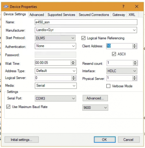

I am trying to read landis e450 meter via Bluetooh on Windows pc. Bluetooth device
can connect successfully to windows. I am attaching the settings screenshot.
Is there something wrong with the settings? I would be pleased if you could support me.

Check that your baud rate is correct. You can change it from "Advanced..." button.

Thanks for your reply. We tried with 9600 which bluetooth supports. Below is showing logs.

Received data is corrupted. One of your serial port settings is wrong.
I believe it should be 9600 8None1.
