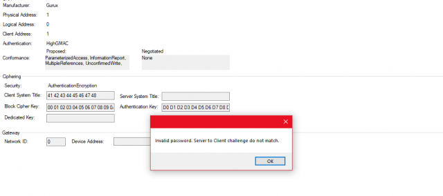

when I want connect to dlms using DLMSDirector "authentication HighGMAC",
but I faced to this answer: "invalide password", while I am sure all passwords were true,
please help me.
I was meaning "blockCipherKey", "authenticationKey" and "systemTitle" were true,
thanks for your time.
HighGMAC authentication doesn't use the password. If you have the password check what authentication you need to use.

What is exact error message that you are receiving? There is no "invalide password" error on GXDLMSDirector.
I sent screen shot.
I sent screen shot.
Your Block Cipher key and Authentication keys are the default ones. Verify them from the meter vendor.

We have released the wrong version from the dll. We'll fix this to GXDLMSDirector and release a new version today.

The new version is released. Restart GXDLMSDirector and update to the latest version.
Thank you, problem was solved
