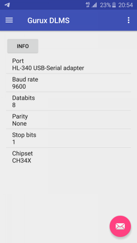

This is screenshot of "media
This is screenshot of "media settings" when i connect my meter
7 years 1 month ago
When you can connect to the meter using GXDLMSDirector are you using the same USB to the serial port converter? Is there an external power supply in your USB 2 serial port converter?
Is your baud rate the same? You are not using an optical head (probe)?
kija
7 years 1 month ago
Yes i am using the same USB
Yes i am using the same USB to the serial port converter. no there is not an external power supply in my USB 2 serial port converter. The baudrate is the same and i am not using and optical head (prode).
