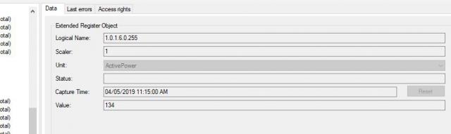

Hey there, I'm trying to read Import Active maximum demand from my smart meter but unfortunately, it gives me the error bytes. My smart meter model is DTSD545 and company manufacturer is Holley Metering System.
First, I read the Maximum Demand from Gurux Director. I attach the screenshot. It successfully gives me the value of demand but when I try to read the maximum demand from my program it gives me an error. The following how I try to read value.

Can you read everything else from this class? In the pic you have read other values.
I believe that you are not doing anything wrong.
This attribute is not implemented to the meter and meter returns error from that.
You should check this from the meter vendor.

I just notest that your class is GXDLMSRegister. It should be extended register.
GXDLMSExtendedRegister register = GXDLMSExtendedRegister("1.0.1.6.0.255");

Content is different. They are totally different registers,
