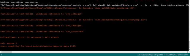

I am trying to do the same, but with Arduino Mega 2560. But, I don't get how to use library with client.ino code. I added "src" and "inlcude" folder in Arduino LIbrary folder. But I was getting compilation error(unable to find library files). Then I added both the folder "src" and "inlcude" in the folder of the sketch then also I got error(During linking).
So, could you please share some steps to configure library files and how to test this codes.
Thank you.

Please, create a new topic if you have a new question. I'll don't always find out new replies to old questions. Can you start a new topic and copy text from the picture. I can't read what are the error codes.
