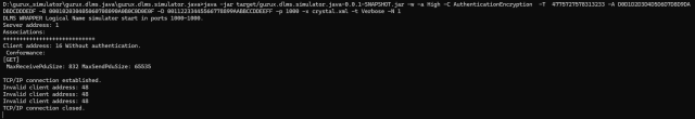

We are doing connection with US association i am attaching the screen shot below please help me to solve the issue
We are getting invalid client address error also I am attaching the command please let me know the correct version of it
also if i am adding -c 48 still i am getting invalid address
java -jar target/gurux.dlms.simulator.java-0.0.1-SNAPSHOT.jar -w -a High -C AuthenticationEncryption -T 4775727578313233 -A D0D1D2D3D4D5D6D7D8D9DA
DBDCDDDEDF -B 000102030405060708090A0B0C0D0E0F -D 00112233445566778899AABBCCDDEEFF -p 1000 -x crystal.xml -t Verbose -N 1

Hi, This template doesn't…
This template doesn't support GMAC authentication or ciphered connections. You need to import a template from the meter that supports ciphered connections.
