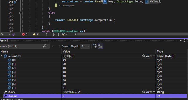

Can you or someone tell me what's wrong with my method? When parsing the received read, I get the response shown in the image

Hi, Have you set the UI type…
Have you set the UI type to the object? Something like this:
obj.SetDataType(attributeIndex, DataType.String);
