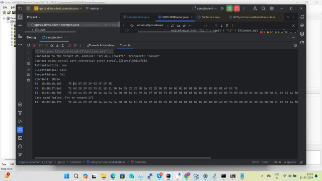

By Sparsh-ht2 , 12 July, 2024 Forums Gurux.DLMS I am not able to get the AARQ response. it is getting failed everytim, even i am using the connection which i used to connect to the DLMS Director. Image THIS IS WHAT I AM GETTING IN… THIS IS WHAT I AM GETTING IN CONSOLE: Connect using serial port connection gurux.serial.GXSerial@6d1e7682 Authentication: Low ClientAddress: 0x14 ServerAddress: 0x1 Standard: INDIA TX: 15:03:59.935 7E A0 07 03 29 93 CF CF 7E RX: 15:04:07.287 7E A0 20 29 03 73 B1 5E 81 80 14 05 02 02 00 06 02 02 00 07 04 00 00 00 01 08 04 00 00 00 01 6F EF 7E TX: 15:04:10.853 7E A0 44 03 29 10 26 4A E6 E6 00 60 36 A1 09 06 07 60 85 74 05 08 01 01 8A 02 07 80 8B 07 60 85 74 05 08 02 01 AC 0A 80 08 41 42 43 44 30 30 30 31 BE 10 04 0E 01 00 00 00 06 5F 1F 04 00 42 1E 5D FF FF C1 A7 7E Data send failed. Try to resend 1/3 TX: 15:05:18.898 7E A0 44 03 29 10 26 4A E6 E6 00 60 36 A1 09 06 07 60 85 74 05 08 01 01 8A 02 07 80 8B 07 60 85 74 05 08 02 01 AC 0A 80 08 41 42 43 44 30 30 30 31 BE 10 04 0E 01 00 00 00 06 5F 1F 04 00 42 1E 5D FF FF C1 A7 7E Data send failed. Try to resend 2/3 TX: 15:06:26.544 7E A0 44 03 29 10 26 4A E6 E6 00 60 36 A1 09 06 07 60 85 74 05 08 01 01 8A 02 07 80 8B 07 60 85 74 05 08 02 01 AC 0A 80 08 41 42 43 44 30 30 30 31 BE 10 04 0E 01 00 00 00 06 5F 1F 04 00 42 1E 5D FF FF C1 A7 7E Disconnected from the target VM, address: '127.0.0.1:53719', transport: 'socket' Process finished with exit code 130 Hi, Your client address is… Hi, Your client address is 0x14. Check that from the meter manual. If it still fails, try to remove Delta value encoding from the "supported services" tab. BR, Mikko
Authentication: Low
ClientAddress: 0x14
Standard: INDIA
