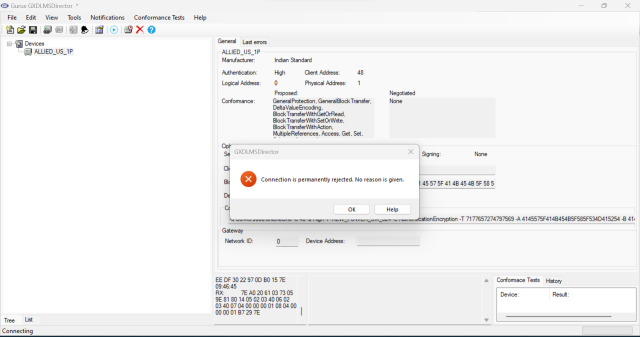

After window 11 installation…
After window 11 installation I am facing GXDLMSDirector also.
I checked all the keys but its showing error like: connection is permanently rejected. No reason is given

Hi, One of your settings is…
One of your settings is different than the meter expects. Can you connect with authentication level None?

Hi Mikko, Yes, I tried but…
Yes, I tried but same thing happen.Its showing error like: connection is permanently rejected. No reason is given
2 years 4 months ago
Hi, You must use the client…
You must use the client address 0x10 when connecting without an authentication level. Are you using it? If you are, try to reboot the meter.

Hi, Did you change the…
Did you change the client address to 10 when connecting without authentication?
Thangalakshmi
Hi Mikko, Yes, Without…
Yes, Without authentication its working but US(Utility Setting) mode its not working.
2 years 3 months ago
Hi, Have you set the…
Have you set the authentication key and block cipher key?
