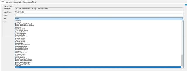

For the power factor, its no unit right? but when I want to read it, come out invalid data.
2 years 7 months ago
Hi, That depends on the…
That depends on the meter. What kind of data are you receiving?
shaaa
I only receive date, time,…
I only receive date, time, current and voltage for L-N, and total power only. Other than that cant read the data. It will show "Invalid data".
Hi, Can you show the hex…
Can you show the hex trace so I can check what might be the problem?
