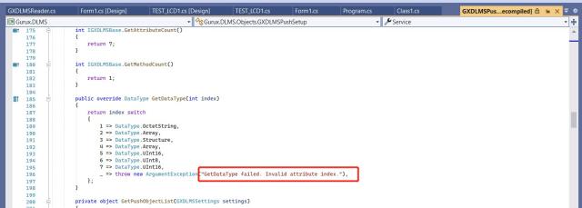

An error occurred when there is an update to the value in attribute number 13 for class_id=40 (in DataType function). However, attribute 1-7 works fine. According to blue book version 14, there was an update to the push interface class to version 2 to support 13 attributes. I would like to know if there is any plan or workaround on this matter?

Hi, Support for version 3 is…
Support for version 3 is on the task list. It's released for C# during this month and other programming languages after that.
