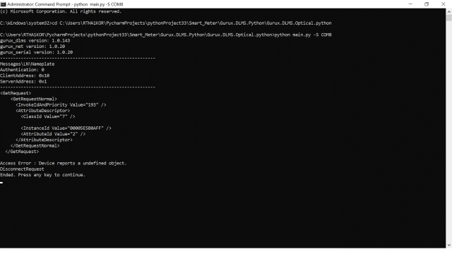

I can successfully execute configuration parameters (Clock and invocation counter) without any errors. But when i try to profiles Read, i am getting Access Error. Please let me know if there are any additional setttings or changes that needs to be done before executing in US type. I have re-validated the passwords and keys and they are as expected. I am pasting the trace below from Command.
C:\Users\RTHA1KOR\PycharmProjects\pythonProject33\Smart_Meter\Gurux.DLMS.Python\Gurux.DLMS.Optical.python>python main.py -S COM8
gurux_dlms version: 1.0.143
gurux_net version: 1.0.20
gurux_serial version: 1.0.20
Messages\LN\Nameplate
Authentication: 0
ClientAddress: 0x10
<GetRequest>
<GetRequestNormal>
<InvokeIdAndPriority Value="193" />
<AttributeDescriptor>
<ClassId Value="7" />
<InstanceId Value="00005E5B0AFF" />
<AttributeId Value="2" />
</AttributeDescriptor>
</GetRequestNormal>
</GetRequest>
Access Error : Device reports a undefined object.

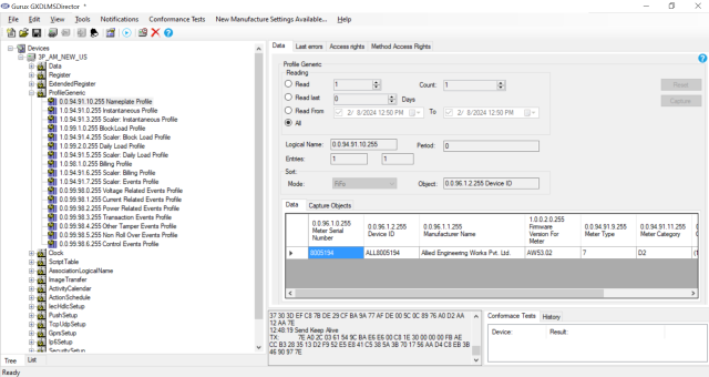

Check that this profile generic is available in the association view. You can easily check it if you download GXDLMSDirector. Try to establish the connection without authentication and the profile generic 0.0.94.91.10.255 should be shown on the left side. If it's not you need to connect using a different authentication level to access it.

Thank You For your response Mikko... GXDLMSDirector I got a response...I'm trying to connect serial Interface (Optical) using python script. I can successfully execute configuration parameters (Clock and invocation counter) without any errors. But when i try to profiles Read, i am getting Access Error.Please help me in reading profiles data from a serial interface using python script.
Authentication: 0
ClientAddress: 0x10
<GetRequest>
<GetRequestNormal>
</GetRequestNormal>
</GetRequest>
Thangalakshmi
2 years 8 months ago
I'm trying to read Nameplate…
I'm trying to read Nameplate profile but i am getting access error.
