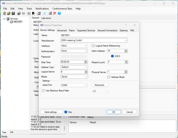

Good day developers and communities,
I have project to connect meter EMH LZQJ-XC with Gurux GXDLMS director using serial interface. The information for this meter is very limited in the web. Please help me to configure this meter as my deadline for this project is near. I already try the default setting for the EMH meter but it failed.

First I need to verify that you are using RS-232 and not an optical probe (head)?
Try to change the address type from Default to SerialNumber. Then set your meter serial number to the serial number box.
