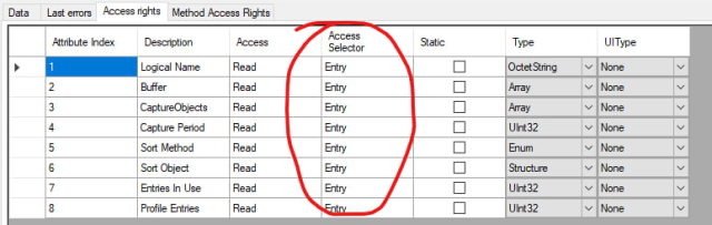

Can you please explain the meaning of the Access Selector field from Access Rights tab of GXDLMSDirector?
How can I set "Entry" values for all fields on my server using C++ lib?

Access Selector tells can you read the profile generic by entry or range. If it is not set, both SHOULD be possible to do. All meters don't use this.
You can't set the Profile Generic Entry value. The meter sets it.

So, how can I set "Entry" values for all fields on my server using C++ lib? =)

If you mean the content of the buffer by entry value, you need to add the same amount of values as there are capture objects. The link below shows how to do it.

I mean how to set Access selector field to see somth like this
