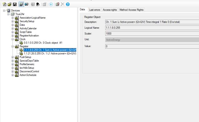

Hello Kurumi, There is no…
Hello Kurumi,
There is no such window. Mine is like attached. Separate OBIS code window, but it does not have search button

Hello, But Description has…
But Description has different meaning. 1.0.1.8.0255 should be active energy, DLMSdirectүж shows Sum Li Active Power ...

Hi, OBIS descriptions are…
OBIS descriptions are coming from DLMS standards.
1.0.1.8.0.255 is Ch. 0 Sum Li Active power+ (QI+QIV) Time integral 1 Rate 0 (0 is total)
You need to select a different OBIS code for active energy.
