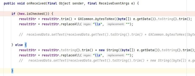

Thanks sir for your kind…
Thanks sir for your kind support and prompt response,
Sir how we notify the use during meter reading if connection is break due to any condition,...
We want to update UI receivedData , if connection is break or no communication
thanks & Regards
arun sharma
2 years 9 months ago
Hi Arun, In serial port…
Hi Arun,
In serial port connection, you don't receive notifications if the connection is broken or lost. You will notest it if you don't receive a reply in a wait time.
