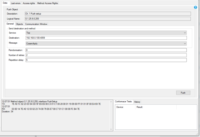

I am working with power meter MT880. I am trying to set-up Ethernet Push for my smart meter (picture in attachment).

I also tried with Gurux software, but also no success - if I press Push button in GXDLMSDirector, I see 3 columns in Wireshark - DLMS, DLMS, TCP.
Hex trace:
12:07:51 Method object 0.1.25.9.0.255, interface PushSetup
TX: 7E A0 1C 02 23 03 54 DD 5F E6 E6 00 C3 01 C1 00 28 00 01 19 09 00 FF 01 01 0F 00 E4 69 7E
12:07:51
RX: 03 00 14 7E A0 12 03 02 23 74 08 79 E6 E7 00 C7 01 C1 00 00 FC B4 7E
Duration: 34
I am missing something, but I don't know what. All other functions work without problems, but the push does not come to the computer.

Hi, When you press the Push…
When you press the Push button, it will ask the meter to send the push message. Because the meter returns an acknowledge message it should send the push message.
Have you set the capture objects? Have you set communication windows when push messages are allowed to be sent?
Make sure that your meter can access the target host 192.168.0.100. Make sure that there are no firewalls, etc that might block the message.
