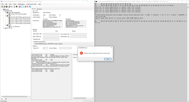

Currently I am using DLMS simulator to act as meter for my dvelopment.
I want SImulator to act same meter
Below is the setup used
1. Created .xml file from meter.
2. Using Manufacturer: Indian Standard, Authentication: PC
1. DLSM Simulator <----> DLMS Director
Media: Net (localhost), Interface: HDLC - Working
Media: Net (localhost), Interface: Wrapper - Working
2. DLSM Simulator <----> DLMS Director
Media: Serial, Interface: HDLC - Working
Media: Serial, Interface: Wrapper - Not Working - Why?
Here Simulator do receive Wrapper frame from Director but not reply for request.
Can you please help to indetify the root cause?
I have attached Screenshot for your reference.

Hi, I have solved my issue…
I have solved my issue with latest DLSM Simulator.
Jigar
2 years 10 months ago
Hi Jigar, I'm sorry for the…
Hi Jigar,
I'm sorry for the slow reply. I'll write the answer, even you solved the problem.
The simulator uses HDLC framing as a default and if the meter sends WRAPPER frames, it doesn't reply to them. The simulator must start using WRAPPER framing and it can be done using -i WRAPPER argument.
