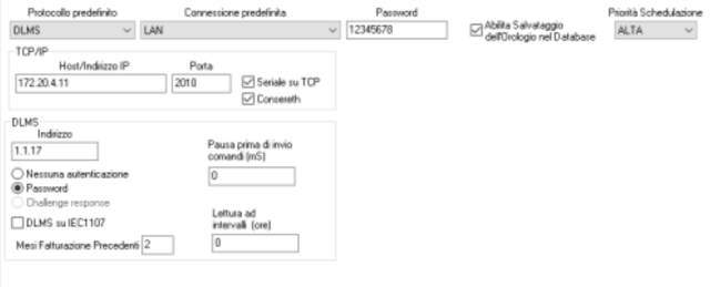

As you can see they are reading the device at address 1.1.17 (well, in the consereth documentation it is said that the default is always 17) but we can't still get any answer.

We found out the issue. The…
The address was not 17 but 145.
I really have no clou why the software shows 17 and the HEX had 145 as address, but still... 128 + 17.
An other non-standard setting in these meters....
