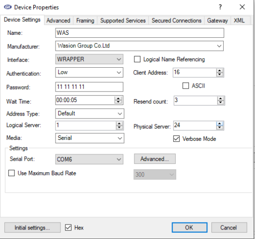

I want to connect Wasion iMeter318 using a serial port what is the configuration to connect it?

Hi, Try to change the…
Try to change the interface from WRAPPER to HDLC.
Then check the serial port settings from the meter documentation.

Thank you! Got it connected…
Thank you!
Got it connected using HDLC with physical address 12.
