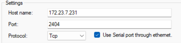

Hi Gurux hope you're doing.
i need your guidance, i'm trying to gain access to my meter remotely over tcp/Ip by using the DLMSDirector .
i know all required parameters and security that i already use in local mode .
i have selected the NET " media" and put the IP address "Host name" and port of my meter.
but the meter didnt reply, of course we are in the same network . It would great if you give us a little help . thanks in advance.

Hi, One of your parameters…
One of your parameters is different from what the meter expects. Check the meter manual what server and client addresses you should use and if the connection is ciphered.
