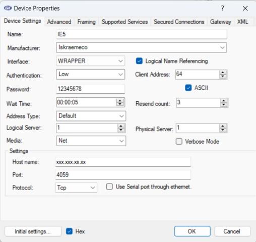

We use to get data from ISKRA meter with GXDLMS for years but we received a few monthes ago a new ISKRA meter the IE.x.
We tried the set up GXDLMS with the same data but we didn't succeed.
Do you have an idea why this one could not connect ?
We are not sure about the parameters we need to set for : client adress - logicial server - physical server.

Hi, Try with those settings:…
Client address: 1.
Logical server 0
Physical address 1.
The settings might vary between the meters, so if you can't connect get the hex trace from the Iskraemeco MeterView and add it here. The first message is enough.
I can check the correct settings for you.
