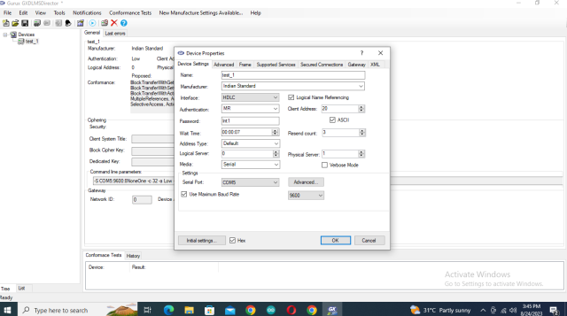

I downloaded the code from Github . https://github.com/Gurux/Gurux.DLMS.Net .
now i want to edit my Authentication values in the code.
MY AUTHENTICATION VALUES ARE :
Interface = HDLC
Authentication = MR
password = lnt1
so in the code i find a line Client.init(true, 16, 1, DLMS_AUTHENTICATION_NONE, NULL, DLMS_INTERFACE_TYPE_HDLC);
i want to know what values should i use there so it will connect to my meter .

Hi, The correct settings are…
The correct settings are:
Client.init(true, 32, 1, DLMS_AUTHENTICATION_LOW, "lnt1", DLMS_INTERFACE_TYPE_HDLC);
Please, if you are using ANSI C, create a new topic if you have a new question.

Hi, Try to connect with…
Try to connect with public client using settings like this:
Client.init(true, 15, 1, DLMS_AUTHENTICATION_NONE, NULL, DLMS_INTERFACE_TYPE_HDLC);
I believe it will work.
Are you using a ciphered connection with GXDLMSDirector? You can see that from the secured connections tab.
