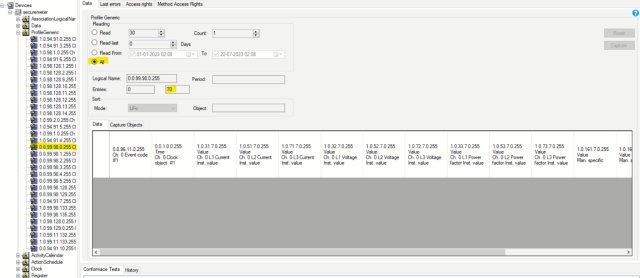

I am trying to read the voltage event from the meter using profile generic 0.0.99.98.0.255 but when I am trying to read all entries it does not give full buffer data.
To cross-verify I tried to read the meter using GXDlmsDirector but got the same result. can you please guide me on what should I do to read all the events? I had tried on two different meters on client 32 but got the same result. for your reference, I am attaching a screenshot of GXDLMSDirector

Hi, The entries in use by…
The entries in use by the picture is zero, so this table is empty and there are no rows.
You have highlighted the Profile entries. It will tell how many rows the might maximum be.
