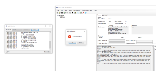

8. At this point I see a flurry of data, but then GXDLMSDirector pops up a dialog "Unacceptable Frame". Can anyone let me know why this is please?
the output in the main GXDLMSDirector window is:
07:48:38 Send SNRM request.
07:48:43 Data send failed. Try to resend 1/3 7E A0 7E A0 2F 81 01 03 6A 65 E6 E7 00 0F C0 00 00 00 00 02 02 09 11 47 52 58 30 30 30 30 30 30 30 30 30 30 33 30 33 00 09 06 00 00 19 09 00 FF 66 E4 7E 7E A0 1E 21 03 73 C3 7A 81 80 12 05 01 80 06 01 80 07 04 00 00 00 01 08 04 00 00 00 01 53 3B 7E
07:48:48 Data send failed. Try to resend 2/3 7E A0 7E A0 2F 81 01 03 6A 65 E6 E7 00 0F C0 00 00 00 00 02 02 09 11 47 52 58 30 30 30 30 30 30 30 30 30 30 33 30 33 00 09 06 00 00 19 09 00 FF 66 E4 7E 7E A0 1E 21 03 73 C3 7A 81 80 12 05 01 80 06 01 80 07 04 00 00 00 01 08 04 00 00 00 01 53 3B 7E 7E A0 1E 21 03 73 C3 7A 81 80 12 05 01 80 06 01 80 07 04 00 00 00 01 08 04 00 00 00 01 53 3B 7E
07:48:49
RX: 7E A0 1E 21 03 73 C3 7A 81 80 12 05 01 80 06 01 80 07 04 00 00 00 01 08 04 00 00 00 01 53 3B 7E 7E A0 1E 21 03 73 C3 7A 81 80 12 05 01 80 06 01 80 07 04 00 00 00 01 08 04 00 00 00 01 53 3B 7E 7E A0 1E 21 03 73 C3 7A 81 80 12 05 01 80 06 01 80 07 04 00 00 00 01 08 04 00 00 00 01 53 3B 7E
07:48:49 Send AARQ request.
TX: 7E A0 2B 03 21 10 FB AF E6 E6 00 60 1D A1 09 06 07 60 85 74 05 08 01 01 BE 10 04 0E 01 00 00 00 06 5F 1F 04 00 62 1E 5D FF FF 88 55 7E
07:48:54 Data send failed. Try to resend 1/3 7E A0 37 21 03 32 7E 5F E6 E7 00 61 29 A1 09 06 07 60 85 74 05 08 01 01 A2 03 02 01 00 A3 05 A1 03 02 01 00 BE 10 04 0E 08 00 06 5F 1F 04 00 00 1E 1D 02 00 00 07 7A ED 7E
07:48:54
RX: 7E A0 37 21 03 32 7E 5F E6 E7 00 61 29 A1 09 06 07 60 85 74 05 08 01 01 A2 03 02 01 00 A3 05 A1 03 02 01 00 BE 10 04 0E 08 00 06 5F 1F 04 00 00 1E 1D 02 00 00 07 7A ED 7E 7E A0 07 21 03 97 2B E1 7E
07:48:54
