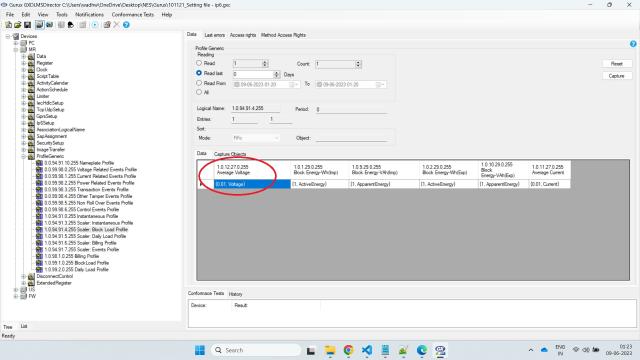

I used GuruxDirector and tried to read the Block Load Profile (MR). I can easily read the value of 1.0.12.27.0.255. See attached screenshot.
Hitesh
3 years 5 months ago
Hi, 1.0.12.27.0.255 is…
1.0.12.27.0.255 is inside the profile generic and you can't access it directly if it's not found in the data objects. This means that the meter saves this value to the profile generic object and you need to read the profile generic object and then find the value from the buffer.
