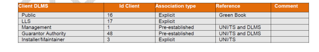

Supported Client ID is…
Supported Client ID is listed in Meter Documentation
