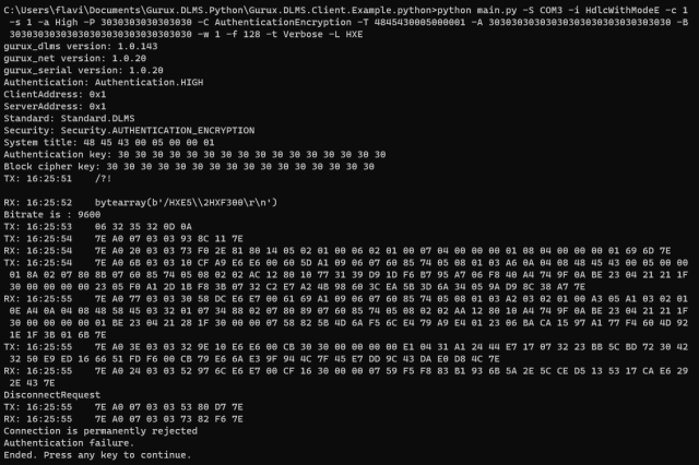

I have a Hexing Meter that I managed to add it to GXDLMSDirector (Using High Authentication with Encryption)
I noticed that the only way to connect to it is using the "Pre-established system title" option, when checking the Command line parameters, i noticed that this value uses the "-M" parameter, which doesn't exist when using the Python application, returning the error "Authentication failure."

Please, don't add pictures in the future. Reading bytes is pain from the images.
A meter system title is added for the command line parameters. Get the latest version from the client example.

i've updated the program with the one Github and the "substring not found" error appears:
The output:
gurux_dlms version: 1.0.143
gurux_net version: 1.0.19
gurux_serial version: 1.0.20
substring not found

The wrong commit was added to the GitHub. It's now updated. Get the latest version.
