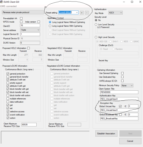

I am using gurux to extract data from energy meter. I need to set the Preset Setting to "LLS-Default" and also set value for Global Unicast Key. Is there any way to do that?

Select "Secured Connections" tab. Then set Block cipher and authentication keys.
Authentication keys is same as in other app.
Block cipher key is Global unicast key.
Then Check "Pre-established system title" and you need to set used system title. I Don't know what client system title your app is using, so you need to ask that from the meter vendor.

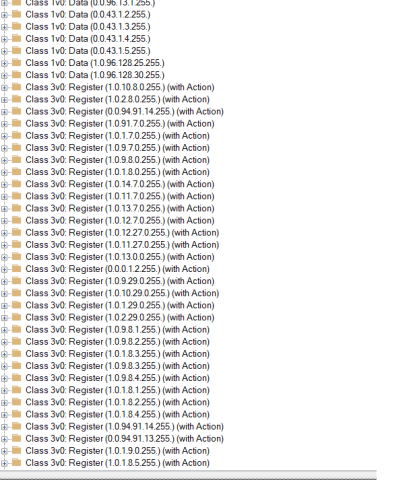

I am using python main.py -S /dev/ttyACM0 -a NONE to acquire data using gurux python. I am getting limited outputs, all class 1 data(Serial number, time etc). The voltage, current etc, which are class 3, are not accessible using this. How should I modify my command to get that using Gurux Python. Attaching my app output image with this for your reference. Even if I use python main.py -S /dev/ttyACM0 -a NONE -g "OBIS CODE for parameter" I am getting "Unknown logical name" error.
