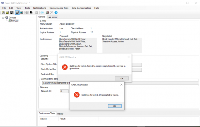

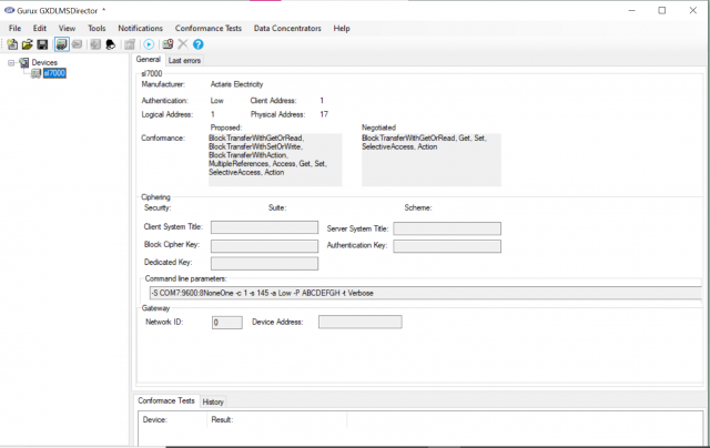

By ikhwan_fn , 16 June, 2021 Forums General discussion Hi all may be you can help me to read itron sl7000 i already can connect to meter but i can not get obis code, the information was invalid Image Hi, Hi, Have you read the association view from the meter? Select "Refresh" from "File" menu. Note! It will take a long time with SL 7000. BR, Mikko Hi Miko Hi Miko When i tried, the notif is "get object failed". can you help what should i do? Image Hi, Hi, Can you connect without authentication? If you add a trace here; I can check it. Pictures don't tell anything. BR, Mikko done, i can clear it Miko. done, i can clear it Miko. and already get the obis code. thankyou so much
