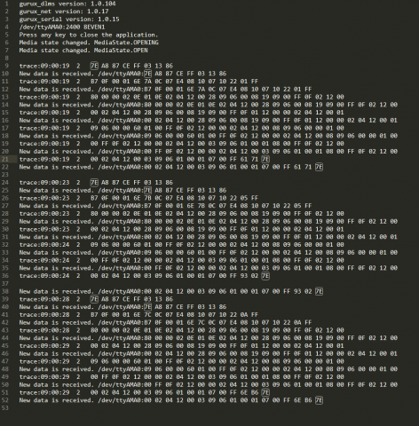

hallmar
5 years 2 months ago
I accidentally set the baud rate to 4800 but it should have been 2400 like I used in the beginning.
Here is the string with the correct Baud rate with the Verbose parameter:
gurux_dlms version: 1.0.104
gurux_net version: 1.0.17
gurux_serial version: 1.0.15
/dev/ttyAMA0:2400 8EVEN1
Press any key to close the application.
Media state changed. MediaState.OPENING
trace:09:00:19 2 7E A8 87 CE FF 03 13 86
New data is received. /dev/ttyAMA0:7E A8 87 CE FF 03 13 86
trace:09:00:19 2 B7 0F 00 01 6E 7A 0C 07 E4 08 10 07 10 22 01 FF
New data is received. /dev/ttyAMA0:B7 0F 00 01 6E 7A 0C 07 E4 08 10 07 10 22 01 FF
trace:09:00:19 2 80 00 00 02 0E 01 0E 02 04 12 00 28 09 06 00 08 19 09 00 FF 0F 02 12 00
New data is received. /dev/ttyAMA0:80 00 00 02 0E 01 0E 02 04 12 00 28 09 06 00 08 19 09 00 FF 0F 02 12 00
trace:09:00:19 2 00 02 04 12 00 28 09 06 00 08 19 09 00 FF 0F 01 12 00 00 02 04 12 00 01
New data is received. /dev/ttyAMA0:00 02 04 12 00 28 09 06 00 08 19 09 00 FF 0F 01 12 00 00 02 04 12 00 01
trace:09:00:19 2 09 06 00 00 60 01 00 FF 0F 02 12 00 00 02 04 12 00 08 09 06 00 00 01 00
New data is received. /dev/ttyAMA0:09 06 00 00 60 01 00 FF 0F 02 12 00 00 02 04 12 00 08 09 06 00 00 01 00
trace:09:00:19 2 00 FF 0F 02 12 00 00 02 04 12 00 03 09 06 01 00 01 08 00 FF 0F 02 12 00
New data is received. /dev/ttyAMA0:00 FF 0F 02 12 00 00 02 04 12 00 03 09 06 01 00 01 08 00 FF 0F 02 12 00
trace:09:00:19 2 00 02 04 12 00 03 09 06 01 00 01 07 00 FF 61 71 7E
New data is received. /dev/ttyAMA0:00 02 04 12 00 03 09 06 01 00 01 07 00 FF 61 71 7E
trace:09:00:23 2 7E A8 87 CE FF 03 13 86
trace:09:00:23 2 B7 0F 00 01 6E 7B 0C 07 E4 08 10 07 10 22 05 FF
New data is received. /dev/ttyAMA0:B7 0F 00 01 6E 7B 0C 07 E4 08 10 07 10 22 05 FF
trace:09:00:23 2 80 00 00 02 0E 01 0E 02 04 12 00 28 09 06 00 08 19 09 00 FF 0F 02 12 00
trace:09:00:23 2 00 02 04 12 00 28 09 06 00 08 19 09 00 FF 0F 01 12 00 00 02 04 12 00 01
trace:09:00:24 2 09 06 00 00 60 01 00 FF 0F 02 12 00 00 02 04 12 00 08 09 06 00 00 01 00
trace:09:00:24 2 00 FF 0F 02 12 00 00 02 04 12 00 03 09 06 01 00 01 08 00 FF 0F 02 12 00
trace:09:00:24 2 00 02 04 12 00 03 09 06 01 00 01 07 00 FF 93 02 7E
New data is received. /dev/ttyAMA0:00 02 04 12 00 03 09 06 01 00 01 07 00 FF 93 02 7E
trace:09:00:28 2 7E A8 87 CE FF 03 13 86
trace:09:00:28 2 B7 0F 00 01 6E 7C 0C 07 E4 08 10 07 10 22 0A FF
New data is received. /dev/ttyAMA0:B7 0F 00 01 6E 7C 0C 07 E4 08 10 07 10 22 0A FF
trace:09:00:28 2 80 00 00 02 0E 01 0E 02 04 12 00 28 09 06 00 08 19 09 00 FF 0F 02 12 00
trace:09:00:29 2 00 02 04 12 00 28 09 06 00 08 19 09 00 FF 0F 01 12 00 00 02 04 12 00 01
trace:09:00:29 2 09 06 00 00 60 01 00 FF 0F 02 12 00 00 02 04 12 00 08 09 06 00 00 01 00
trace:09:00:29 2 00 FF 0F 02 12 00 00 02 04 12 00 03 09 06 01 00 01 08 00 FF 0F 02 12 00
trace:09:00:29 2 00 02 04 12 00 03 09 06 01 00 01 07 00 FF 6E B6 7E
New data is received. /dev/ttyAMA0:00 02 04 12 00 03 09 06 01 00 01 07 00 FF 6E B6 7E

If you can get a hex trace of how Map120 is handling this I can solve the correct settings from the byte stream. I need only trace from push messages.
hallmar
Is the hex trace that I posted at the start of this thread not enough for this?
If not then I will ask our guy from the energy company to give us the hex trace from the meter :)
-Hallmar
No, I need all the frames that the meter and client app sends to check all the frames.

I've had a meeting with the man from the energy company and he says that the hex trace that I've shown is the hex trace that the meter is sending via a push message over the M-Bus, there is nothing else to the message.
We tried reducing the objects that are sent via push messages and the same error came about 'not enough data'. The last step that we took was to remove the 'object list' message in the push message and at that point the script still just gave me the raw hex stream BUT right now I can read in the XML code what the Watt hours are and the 'error not enough data' is gone. In the example below that is
4D3B in hex which is 19771Wh in decimal, and that fits!
So right now I'm at a point where I just need to be able to translate that raw bytestream to XML and then I can write some python code to parse the XML code and get the Watthours value.
