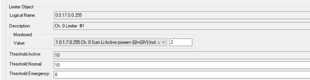

Hi Mikko, thanks for the…
thanks for the update, can i ask if it's in the pipeline?, as i can see the same in dlms director but isn't populated using the java library.
I have attached the screenshot from director
2 years 8 months ago
Hi, That is implemented…
That is implemented differently between C# and Java. This is changed for Java and it's updated for the next version. Most meters include all objects in association view and this is not causing problems. Your meter is an exception from this.
