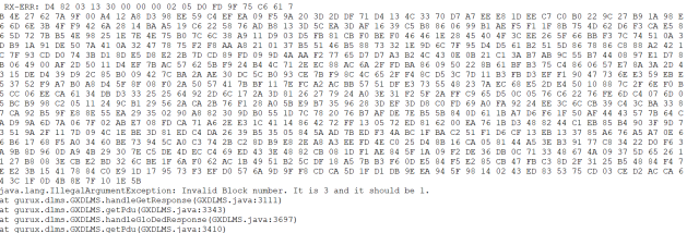

Hi Gurux,
We are getting "getting Invalid Block number. It is 3 and it should be 1.
" exception while reading Billing Profile from meter. This error only coming for "1.0.98.1.0.255" remaining obiscode's are readed by JAVA DLMS implementation.
gurux Dlms version is 4.0.21
We didn't facing this issue while reading Billing Profile via Gurux DLMS Directory (9.0.23XX)
I am providing logs for your reference

RX-ERR: D4 82 03 13 30 00 00 00 02 05 D0 FD 9F 75 C6 61 7
B 4E 27 62 7A 9F 00 A4 12 A8 D3 98 EE 59 C4 EF EA 09 F5 9A 20 3D 2D DF 71 D4 13 4C 33 70 D7 A7 EE E8 1D EE C7 C0 B0 22 9C 27 B9 1A 98 E
6 6D 6E 3B 4F F9 42 6A 28 14 BA A5 19 C6 22 58 76 AD B8 13 3D 5C EA 3D AF 16 39 C5 B8 86 06 99 B1 AE F5 F1 1F 8B 75 4D 62 D6 F3 CA E5 8
6 5D 72 7B B5 4E 98 25 1E 7E 4E 75 B0 7C 6C 38 A9 11 D9 03 D5 FB 81 CB F0 BE F0 46 46 1E 28 45 40 4F 3C EE 26 5F 66 BB F3 7C 74 51 0A 3
D B9 1A 91 DE 50 7A 41 0A 32 47 78 75 F2 F8 AA A8 21 01 37 B5 51 46 B5 88 73 32 1E 9D 6C 7F 95 D4 D5 61 B2 51 5D 86 78 86 C8 88 A2 42 1
C 7F 93 CD D0 74 3B D1 8D E5 D8 E2 2B 7D CD 89 FD 09 9D 4A AA F2 77 65 D7 D7 A3 B2 4C 43 0E 0B 21 C1 3A B7 AB 9C 55 B7 44 08 97 E1 D7 8
B 06 49 00 AF 2D 50 11 D4 EF 7B AC 57 62 5B F9 24 B4 4C 71 2E EC 88 AC 6A 2F FD BA 86 09 50 22 8B 61 BF B3 75 C4 86 06 57 E7 8A 3A 2D 4
3 15 DE D4 39 D9 2C 85 B0 09 42 7C BA 2A AE 30 DC 5C B0 93 CE 7B F9 8C 4C 65 2F F4 8C D5 3C 7D 11 B3 FB D3 EF F1 90 47 73 6E E3 59 EB E
5 37 52 F9 A7 B0 A8 D4 5F 8F 08 F0 2A 50 57 41 7B BF 11 7E FC A2 AC BB 57 51 DF E3 73 55 48 23 7A EC 68 E5 2D E4 50 10 88 7C 2F 6E F0 B
5 CC 06 EE CA 61 34 DB D3 33 25 25 64 92 2D 6C 17 2A 3D 81 26 27 79 24 A0 3E 31 F2 5F 2A FF C9 65 D5 0C 05 76 C6 22 76 FE 6D C4 07 6D 0
5 BC B9 98 C2 05 11 24 9C B1 29 56 2A CA 2B 76 F1 28 A0 5B E9 B7 35 96 28 3D EF 3D D8 C0 FD 69 A0 FA 92 24 EE 3C 6C CB 39 C4 3C BA 33 8
7 CA 92 B5 9F E8 8E 55 EA 29 35 02 90 A8 82 30 9D B0 55 1D 7C 78 20 76 B7 AF DE 7E B5 5B 84 0D 61 1B A7 D6 F6 1F 50 AF 44 43 57 7B 64 C
A D9 9A 6D 7A 06 7F 02 AB E7 08 FD CA 71 A6 2E E3 1C 41 14 86 42 72 FF 13 05 72 ED 81 62 00 EA 76 1B D3 48 82 44 C1 EB 85 B4 90 3F 9D 7
3 51 9A 2F 11 7D 09 4C 1E BE 3D 81 ED C4 DA 26 39 B5 35 05 84 5A AD 7B ED F3 4A BC 1F BA C2 51 F1 D6 CF 13 EB 13 37 85 A6 76 A5 A7 0E 6
6 B6 17 68 F5 A0 34 60 BE 73 94 5C A0 C3 74 2B C2 8D B9 E8 2E A8 A3 EE FD 4E C0 25 D4 8B 16 CA 05 81 44 A5 3E B3 91 77 C8 34 22 D0 F6 3
A 9B 8D 96 0D A9 4B 29 30 7E C5 DE 4D EC C4 69 ED 43 3E 48 82 CB 08 1D F1 AE 84 5F 1A 09 F2 DE 36 DB 0C 71 33 48 67 4A 09 37 5D 65 26 1
1 27 B8 08 3E CB E2 BD 32 6C BE 1F 6A F0 62 AC 1B 49 51 B2 5C DF 18 A5 7B B3 F6 0D E5 84 F5 E2 85 CB 47 FB C3 8D 2F 31 25 B5 48 84 F4 7
E E2 3B 15 41 78 84 C0 E9 1D 17 95 73 F3 EF D0 57 6A 9D 9F F8 CD CA 5D 1F D1 DB 9E EA 94 5F 98 14 02 43 ED 83 53 75 CD 03 CE D2 AC CA 6
4 3C 1F 0D 4B 8E 7F 10 1E 5B
java.lang.IllegalArgumentException: Invalid Block number. It is 3 and it should be 1.
at gurux.dlms.GXDLMS.handleGetResponse(GXDLMS.java:3111)
at gurux.dlms.GXDLMS.getPdu(GXDLMS.java:3343)
at gurux.dlms.GXDLMS.handleGloDedResponse(GXDLMS.java:3697)
at gurux.dlms.GXDLMS.getPdu(GXDLMS.java:3410)
at gurux.dlms.GXDLMS.getData(GXDLMS.java:3872)
at gurux.dlms.GXDLMSClient.getData(GXDLMSClient.java:2844)
at gurux.dlms.client.GXDLMSReader.readDLMSPacket(GXDLMSReader.java:313)
at gurux.dlms.client.GXDLMSReader.readDataBlock(GXDLMSReader.java:237)
at gurux.dlms.client.GXDLMSReader.read(GXDLMSReader.java:538)
at io.github.resilience4j.retry.Retry.lambda$decorateFunction$7(Retry.java:355)
at java.base/java.util.stream.ReferencePipeline$3$1.accept(ReferencePipeline.java:195)
at java.base/java.util.stream.ReferencePipeline$2$1.accept(ReferencePipeline.java:177)
at java.base/java.util.ArrayList$ArrayListSpliterator.forEachRemaining(ArrayList.java:1655)
at java.base/java.util.stream.AbstractPipeline.copyInto(AbstractPipeline.java:484)
at java.base/java.util.stream.AbstractPipeline.wrapAndCopyInto(AbstractPipeline.java:474)
at java.base/java.util.stream.ReduceOps$ReduceOp.evaluateSequential(ReduceOps.java:913)
at java.base/java.util.stream.AbstractPipeline.evaluate(AbstractPipeline.java:234)
at java.base/java.util.stream.ReferencePipeline.collect(ReferencePipeline.java:578)

2 years 6 months ago
Hi, The DLMS standard says…
The DLMS standard says that the first block ID should be one and now your meter is returning block ID #3. You need to ask the meter vendor if there is a firmware update that fixes this.

Hi Gurux,
same Billing profile read working fine from gurux dlms directory software
Hi, If you can read this…
If you can read this with GXDLMSDirector then you are doing something differently in your code or you are reading something else that resets the block number before reading the billing profile.
