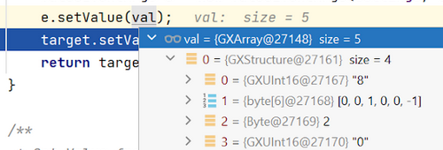

Profile Generic Read All…
BlockLoad Profile
We are unable to read Billing Profile because getting Byte[] objects.Can you please guide how to convert to value in Java?
Refer the Screenshot attached here Byte[0,1,2,3]. How to get the values from Byte[]?
Thanks. You response is very much appreciated.
SmartMeterAndroid
2 years 8 months ago

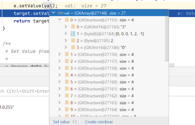

Billing Profile Profile…
Billing Profile
Refer the Screenshot attached here Byte[0,1,2,3......]. How to get the values from Byte[]?
Hi, The byte array UI data…
The byte array UI data type depends on the capture object.
In this case, you can set the data type to octet-string for the second object.
Something like:
GXClock clock = //Find clock object;
clock.setUIDataType(2, 2, DataType.OCTET_STRING);
You need to check the object type and attribute index because I don't know what you are reading.

Reading the Billing Profile…
We are reading the billing Profile.But getting Byte[] values. So how to convert this to in value in Android?
Please share the complete code.
Thanks. Your response is much appreciated
Hi, As I told you earlier…
As I told you earlier you need to add capture objects manually and set the UI data type for those objects. You can also loop all cells and if it's a byte array you can convert it to the desired format with GXDLMSClient.changeType -method like this.
byte[] data = (byte[]) your_data;
Object value = GXDLMSClient.changeType2(data, DataType.OCTET_STRING, true);
SmartMeterAndroid

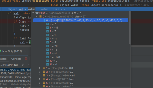

We cant able to parse byte[]…
We cant able to parse byte[] values.Can you please help here? (Find screenshot)
Object val = value;
if (val instanceof byte[]) { // is not executing (in this case type is NONE)
DataType type = target.getUIDataType(attributeIndex);
if (type == DataType.DATETIME && ((byte[]) val).length == 5) {
type = DataType.DATE;
target.setUIDataType(attributeIndex, type);
if (type != DataType.NONE) {
val = changeType((byte[]) value, type, settings);
Thanks . Your response is much appreciated.
Hi, This looks like date…
This looks like date-time data. You need to set GXDLMSClock object to the first object in the capture objects. You can also convert it like this:
Object value = GXDLMSClient.changeType2(data, DataType.DATE_TIME, true);
SmartMeterAndroid

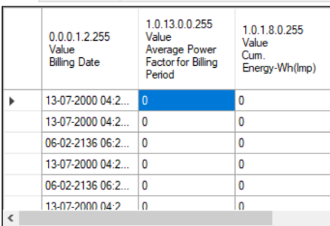

SmartMeterAndroid
Can't able to read the…
Can't able to read the Values
We can able to read Pos 0(Billing Date - Screen attached). But We can't able read Pos 1(Average power factor billing period - Screen attached) Getting "Device reports a Unavailable object" Error.
We need to read multiple column values with table in Android app as like in DLMSDirector.
Thanks. Your response is much appreciated.
Hi, An unavailable object…
An unavailable object should mean that the OBIS code is wrong, but I believe that in your case you try to read it using readRowsByRange or readRowsByEntry and the meter doesn't support that.
Read meter rata in the same way as you are doing with GXDLMSDirector.
SmartMeterAndroid

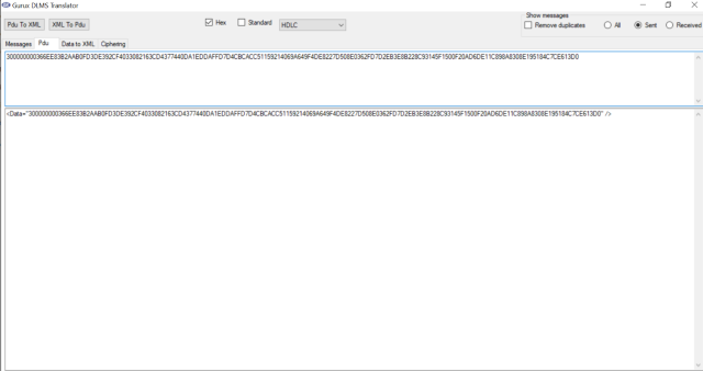

Translating PDU to XML will…
Translating PDU to XML will getting <Data> Tag only
Please help me this conversion is wrong? What we missing here?
Please refer the attached screen
Hi, Please, don't add pics…
Please, don't add pics. They are hard to read. Plain text is better.
Your PDU is not complete. Have you set block cipher and authentication keys for your code? I believe it's better if you read your meter with GXDLMSDirector first.
You can easily set all meter settings and it's easier to verify communication.

While translating to PDU getting the value this
"300000000278C8469D5A2A607D0768927A7DB5C0205EF24C75D757FA9112FFBA464B147A66AE28AAAD475352BB226826BC12924B68CE1C9E3FF0B021140F947A96BFBB3946E0163B968BC2C47E7CC90AA3"
Converting the above PDU to XML in DLMSTranslator is not getting XML value.
Authentication successfully added.
Hi, You need to set the…
You need to set the correct block cipher and authentication keys to encrypt this.
Make sure that you have enable the comments.
setComments(true);
SmartMeterAndroid
Thanks for your reply. We…
We have added the block cipher and authentication keys, comments . But getting the same.
val translator = GXDLMSTranslator(TranslatorOutputType.SIMPLE_XML)
translator.blockCipherKey = Same like in DLMSDirector
translator.authenticationKey = Same like in DLMSDirector
translator.systemTitle = Same like in DLMSDirector
translator.isComments = true
