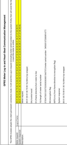

Gurux.DLMS.AMI
I would like to know if dlsm ami can accept this query codes
3 years 4 months ago
Hi, You can create a script…
You can create a script that handles this. That script needs to parse the received login message and find the meter using Logical Device Name.
We can check this script at the beginning of August.
