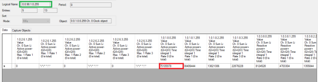

Gurux DLMS for Android
Best wishes to you, Kurumi.
Please could you help me to read a specific row(s) for a profile generic (see pic below).
I'am using Gurux.DLMS.Android. Thank you so mutch.
Regards.
3 years 6 months ago
Hi, You need to read buffer…
You need to read buffer from the profile generic using read by range or by entry methods. Then you need find correct value from the returned data.
Check link below. It will do what you want to do.
https://github.com/Gurux/GuruxDLMS.c/blob/136207781359516d959ee0c3ebf26…
Profile picture for user oulahsensaid
Thank you Mr. Kurumi. This…
Thank you Mr. Kurumi. This link for C proramming.
I found what I'm looking for.
All the best for you.
