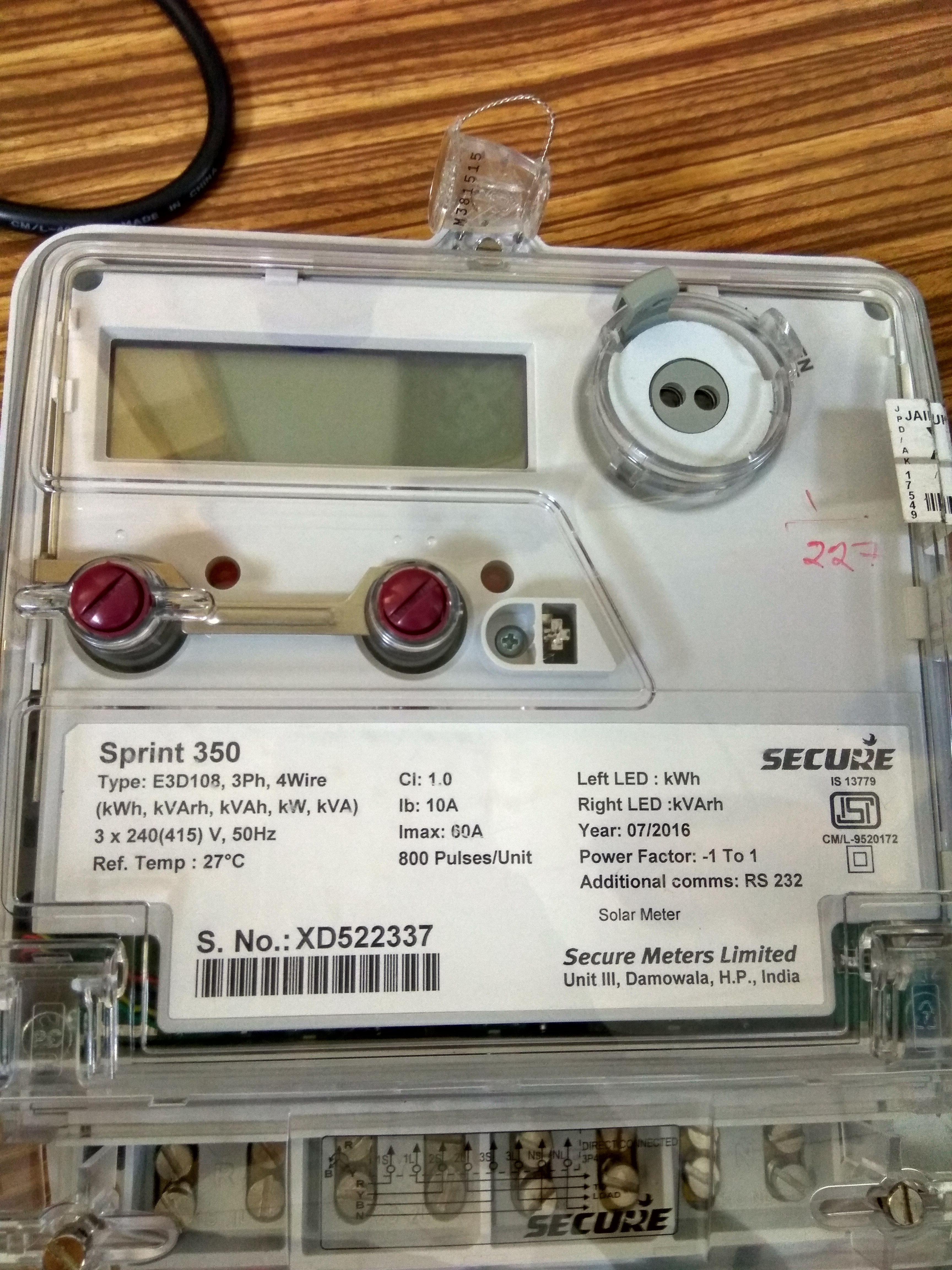

Hi ,
I am trying to get live data from secure meter sprint 350 to my remote server data base. In meter there is a RJ11 port is also available for communication . So can anyone help how can i get solution for this.Meter pic are attach in attachment.

You can try to read this meter with GXDLMSDirector. Select "Indian standard" as manufacturer.
Then you need to set serial port settings and read meter. You can use Gurux.DLMS.Net, Gurux.DLMS.java or Gurux.DLMS.cpp to make your own app that sends data where you want to.

Hi Mikko ,
First of all thank you so much for your reply. I have tried to read data as per your suggestion by connecting meter with my laptop by cable (Pic : https://s13.postimg.org/whp4cj5d3/Secure_Meter_connection_cable.jpg) but not able to get data. So can please help me to get out from the issue.Is there any other way or issue is with that female to female cable(mentioned in pic) or any other reason.

Secure Meter Issue
Please, remove those loops from the cable. That might cause problems. Are you sure that your wiring is correct? I can say that it's very common that is not.
