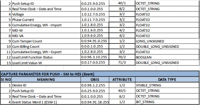

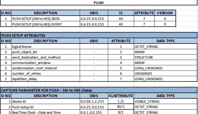

I have the following details:
Captain America
7 years 2 months ago
In reply to yeah i will ask them ... and by Captain America
Continuation of the data
