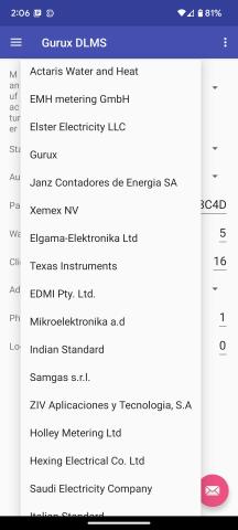

I was trying to compile DLMS Android Sample on my Android Studio Dolphin 2021/Win 11 was able to build the apk with as is code, but when I tried to test it on my Google Pixel using Optical Probe on Genus meter [working fine on GxDLMSDirector] it didnt open the settings page for some error.. I realized the error was on Authentication block on GxSettings.Java
When I commented out the following lines and regenerated apk, it actually started opening the meter settings page, but now my Genus meter is not listed in Manufacturers list with this code commented.

as well as getting this screenshot error when using a different cable - The meter is Genus
