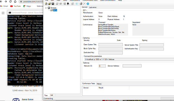

I have refer your vedio https://www.youtube.com/watch?v=KJT2ftPg3cQ, for the intigration.

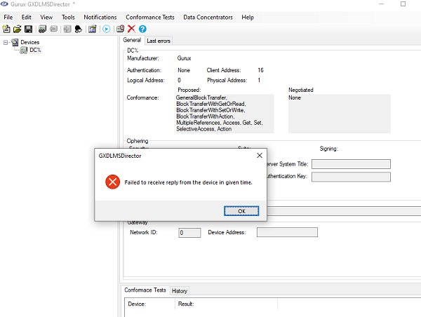

We are able to run the dotnet Gurux.DLMS.AMI.dll but as per video we are not receivng the ACK data and getting connection fail.
Vedio Time: 1:07
I have attached few screenshots. Please help to find the issue.
-h localhost -p 1000 -w 1 -f 128 -t Verbose

Try to connect with GXDLMSDirector for your meter. I believe that your client or server address is wrong.
Do you have a server example that is listening to port 1000?
