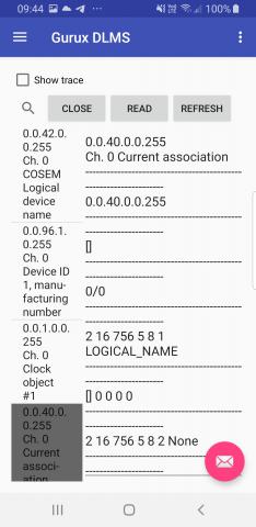

I am trying to create application that read meter reading , I have the Gurux Android Application and meter is connected with optical probe.
I am getting some data and traces as attached screenshots .
But I don't know how to proceed further , i have 2 questions for now
* How to get the meter reading after connecting?
* Is there any step wise document for Android application?
I am new for this kind of application , Please help or suggest how can to proceed.

Select object that you want to read and press Read. The meter is read in the same way as all client examples. The best way to get started is if you download the GXDLMSDirector and read the meter with it. In that way, you will have an idea of how DLMS meters work and what you want to read.
You should read this first to get started:
https://www.gurux.fi/Gurux.DLMS.Client
