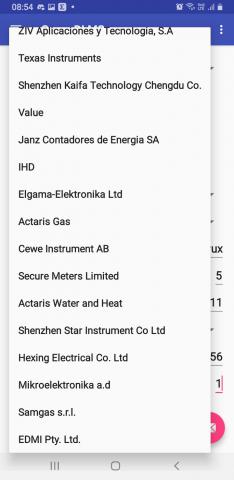

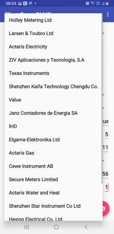

Manofacturers
Manofacturers
JorgeM
5 years ago
Manofacturers 2, I don't find
Manofacturers 2, I don't find an Arduino item in the list! I configure Value and I try with this option!

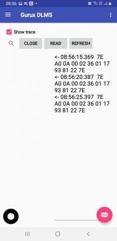

Trace!
Trace!
