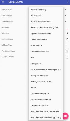

Unfortunately I can't see the
Unfortunately I can't see the LandisGyr on the list (screenshot attached)
Thanks.
5 years ago
It should be there. I can test this on Friday.

You were right and this is now fixed. Get the latest version from GitHub and you can see Landis+Gyr. Also, Italy and India authentication rights are shown better.
Thank you for pointing this out.
