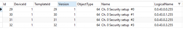

Is it a setting in device properties? Can I change this setting via the interface AMI?
This object in the database has version 1.
5 years 7 months ago
This is fixed. Get the latest version and let me know if you have problems. We are just adding support for Securit Suite 1 and 2.
