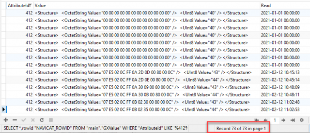

There are 73 records left in
There are 73 records left in the table GXValues after re-read.

Yes, that's right, there are 75 records in the device, in base 73. On an empty base, all events are read for the first time, on subsequent readings of the object, events are not accumulated in the database, clearing table GXValues does not help.

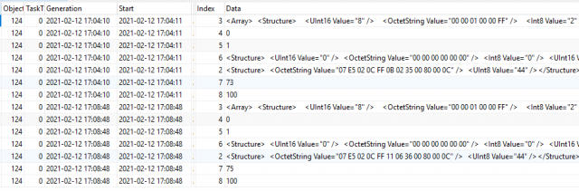

Can you add hex trace from Gurux.DLMS.AMI so I can verify the bytes?
MNN
5 years 7 months ago
Hello.
Hello.
Empty base created, first read of device log (75 events):

It is noticed that after
It is noticed that after reading the event log in table GXAttribute, the date of reading the attribute in field "Read" is set. After that, when reading the event log, no new events are written. If the value of this field is set to "0001-01-01 00:00:00", new events are written to the database.
Your meter is returning a strange date-time field. It says that deviation is not used and it's OK, but then there is a skipped flag and it's saying that some of the data is not used.
07E50205FF09352E00800005 //Year and day is skipped.
07E5020CFF0A30090080000C //Hour and Month is skipped.
This will cause that data is not saved to the DB.
You need to ask from the meter manufacturer what is the idea of this? I believe that this a meter issue.

An empty sqlite database has been created. First reading of the event log (2 entries).

Events generated.
Second reading of the event log (7 entries), but there are still 2 entries in the database.

MNN
5 years 6 months ago
I select "Ignore Time Zone"
Hello.
I select "Ignore Time Zone" in GXDLMSDirector and and read the object:
When you read data with GXDLMSDirector there is only one row in the meter. When you read the meter with AMI, the meter returns invalid date-time.
<!-- *.*.* 0.00.00 -->
<OctetString Value="000000000000000000000000" />
You need to ask if there is an issue with the meter.
