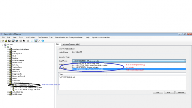

I am having a problem on gurux dlms director.
in the Action schedule push it is showing all scripts under script name. there only push related script has to be present.
please find that in attachment.
5 years 11 months ago
I understand your idea, but the DLMS standard doesn't define what are script OBIS codes can be executed here. For this reason, we can't filter extra scripts.
