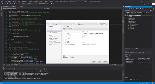

I want to do serial communication using the gurux DLMS Client Example of GuruxDLMS.c, but I am curious how to set it up.
5 years 7 months ago
Picture is compressed and I can't read it clearly, but if you are using serial port connection you need to set serial port parameters like this:
-P COM3
ANSI C expects that settings are 8None1. If your meter is using something else you need to change then to the source code.
