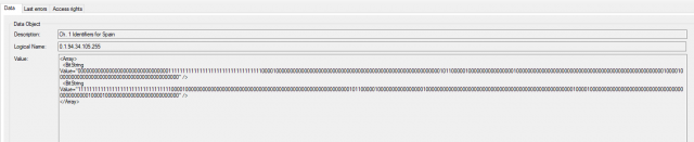

We downloaded the latest release and we are testing the type array of bit-string and array of octet-string. We were able to create both successfully but we were not able to understand how to manipulate it.
In fact, we want to create an Array [2] of Bit-string[256] with:
- Array[0] = Default value : 1 for all bits
- Array[1] = Default value : 0 for all bits
We were not able to assign the desired values and initialize the array created. How are we supposed to access each bit of the bit-string to set it to 1 or 0?
INIT_OBJECT(eventLogFilter_standardEventLog, DLMS_OBJECT_TYPE_DATA, ln)
static uint32_t BUFFER[2][1];
BUFFER[0][0] = 0;
BUFFER[1][0] = 0xffffffff;
static dlmsVARIANT ARRAY[2];
GX_BIT_STRING(ARRAY[0], BUFFER[0], 256);
GX_BIT_STRING(ARRAY[1], BUFFER[1], 256);
static variantArray tmp;
VA_ATTACH(tmp, ARRAY, 2);
GX_ARRAY(eventLogFilter_standardEventLog.value, tmp);
We wrote this above code expecting to have the result described but we obtained another result (check the picture).
Can you guide us or correct us to obtain what we want? We are not sure if it is a bug or we are not understanding how to use it right.

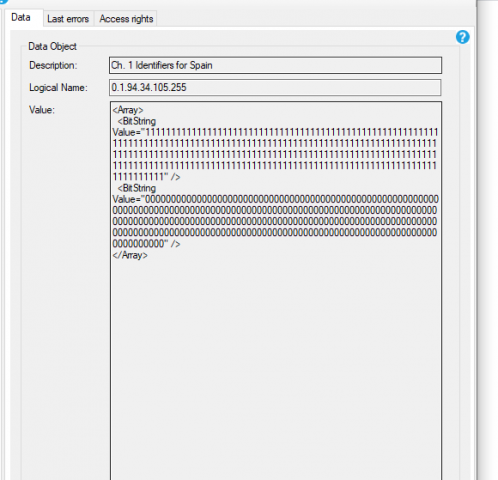

Hello Mikko,
Hello Mikko,
Just want to tell you that we solve the above problem by writing this code:
static char BUFFER[2][32];
for (int i = 0; i < 32; i++)
BUFFER[0][i] = 0xff;
BUFFER[1][i] = 0;
You can check the result in the attached picture.
Best Regards,
Lara Wakim
5 years 9 months ago
I'm sorry for the slow reply. I was out of the office yesterday.
You can also create different buffers if you like to. Reading might be easier.
static char BUFFER_1[32];
static char BUFFER_2[32];
