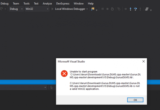

Its giving error when i am using win 32 in visual studio. Check below image.
5 years 10 months ago
I believe that you try to start Gurux.DLMS.library. You need to open GuruxDLMSClientExample and start that.

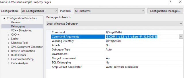

I have provided the arguments
I have provided the arguments but its showing authentication failure. And still I didn't get the idea of downloading instant profile from this code. Plz provide an example.
Can i include dlms c++ library in my new c++ project in visual studio?
Remove [] around your password.

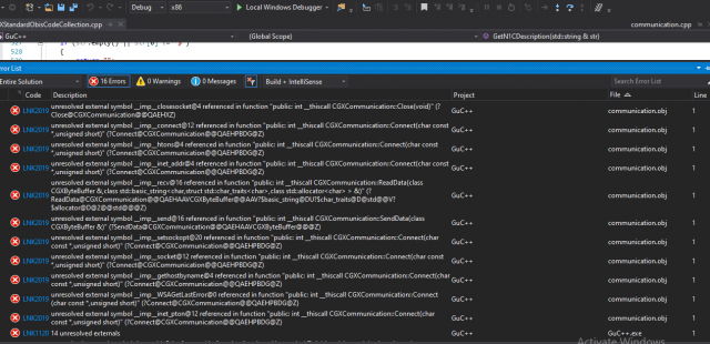

Started a new c++ project in
Started a new c++ project in visual studio and included all the files in that project.
After building the project these type of errors are coming. Any suggestions??
I want to start new c++ project and include c++ library to download meter. Plz help
Please, don't add pics like this. They are compressed and I can't see the error code.
You haven't added linker dependencies. Add those:
