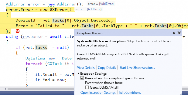

I need to start reading the attribute by schedule and reading until it is read. After that, I need to delete the required record from the GXScheduleToAttribute table, since you no longer need to read the attribute.
I use api DeleteScheduleTarget, sending the package {"Attributes": [3618], "Schedules":[4]} and an error occurs.
How can I stop the schedule?
System.NullReferenceException
HResult=0x80004003
Message=Object reference not set to an instance of an object.
Source=Gurux.DLMS.AMI
StackTrace:
at Gurux.DLMS.AMI.Reader.ReaderService.<DoWork>d__13.MoveNext() in ..\Gurux.DLMS.AMI\Reader\ReaderService.cs:line 398
